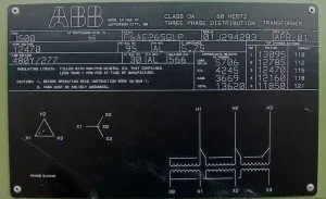

Three-phase transformers contain some valuable data on their nameplate such as the kVA rating, primary and secondary voltage, and percent impedance. With this minimal data, you can calculate the worst case short circuit current through a transformer. The calculation will provide the three-phase rms symmetrical short circuit current on the secondary bus of the transformer. This process only has two simple calculation steps:

1500kvaHere is an example of the calculation:
The existing transformer is rated 1500 kVA with a secondary voltage of 480Y/277V and an impedance of 5.75%.
