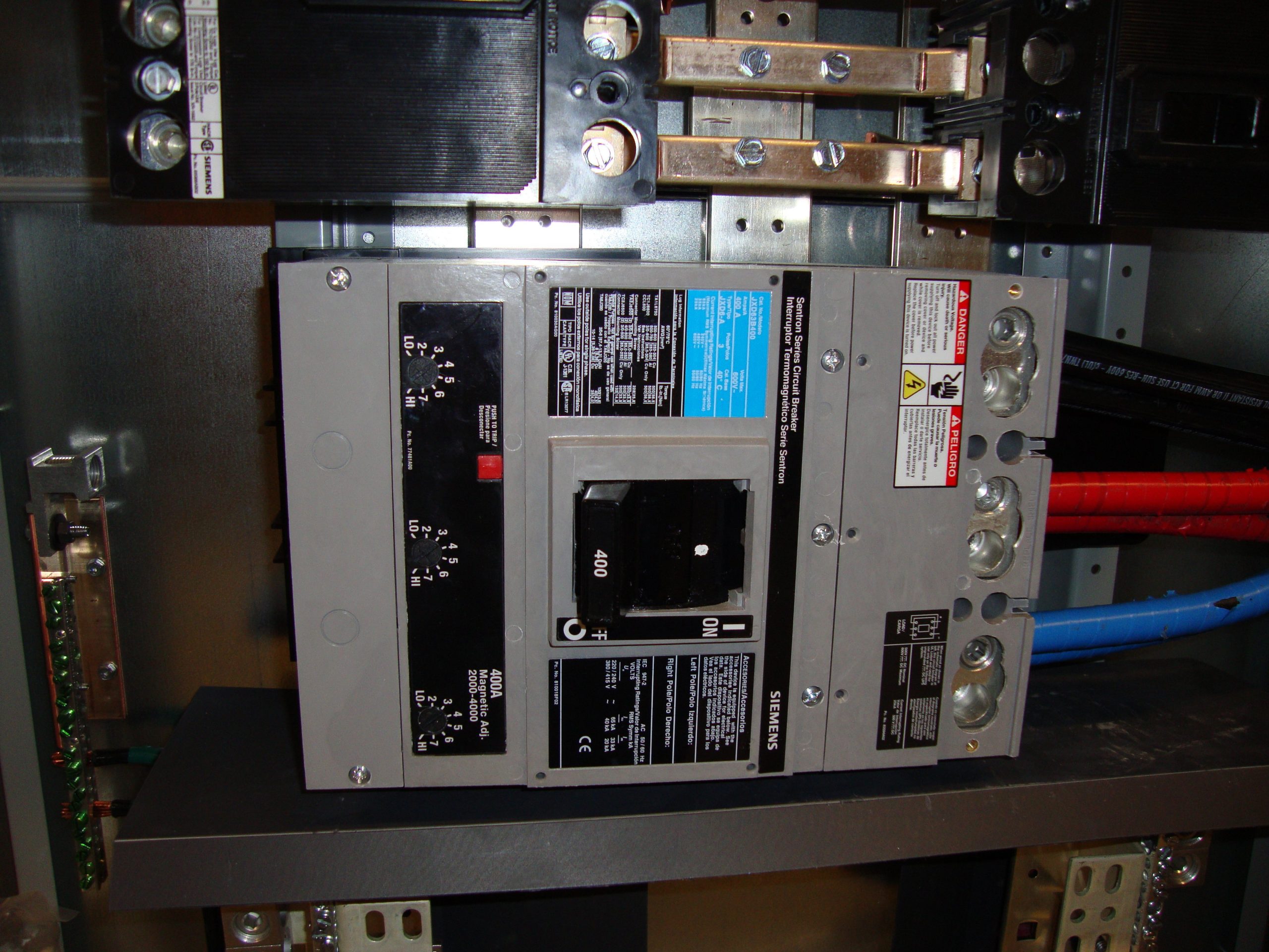

Circuit Breaker SettingsThe circuit breaker just tripped.  Production is down, alarms are sounding in the background.  Panic time.  For many, this scenario would mean quickly re-set the circuit breaker and “see what happens.”  Not the best idea – the question needs to be asked – why did the circuit breaker trip?  This situation can become an even larger problem if the circuit breaker has setting adjustments.  Before I go any further, let’s back up a few steps.
Adjustable Circuit Breakers
Many circuit breakers have setting adjustments that can be used to define how the device responds to short circuit currents.  Adjustable circuit breakers as a minimum, will have an adjustable instantaneous setting that defines the level of current where it will trip with no intentional time delay. a.k.a. instantaneous trip.  If the abnormal current exceeds this current level, the device trips instantaneously – if the current is less than this level, it will trip in the time delay or overload region.
Other more complex devices such as electronic trip and digital breakers can have a multitude of settings that are used to define an elaborate tripping characteristic.  The preferred method for determining the settings for these devices is to perform a coordination study. This requires that the various protective device in the electric power system be analyzed to determine how they should be set so only the device furthest downstream nearest the load trips in the event of an abnormal current.  This allows the other devices towards the source to remain closed and results in the minimum amount of an outage.
However, there is another objective and that is to ensure that the protective device also responds quickly enough to provide suitable protection of the conductors, transformers, motors and other electrical equipment.  The recommended settings should take into account both selective coordination and protection.
