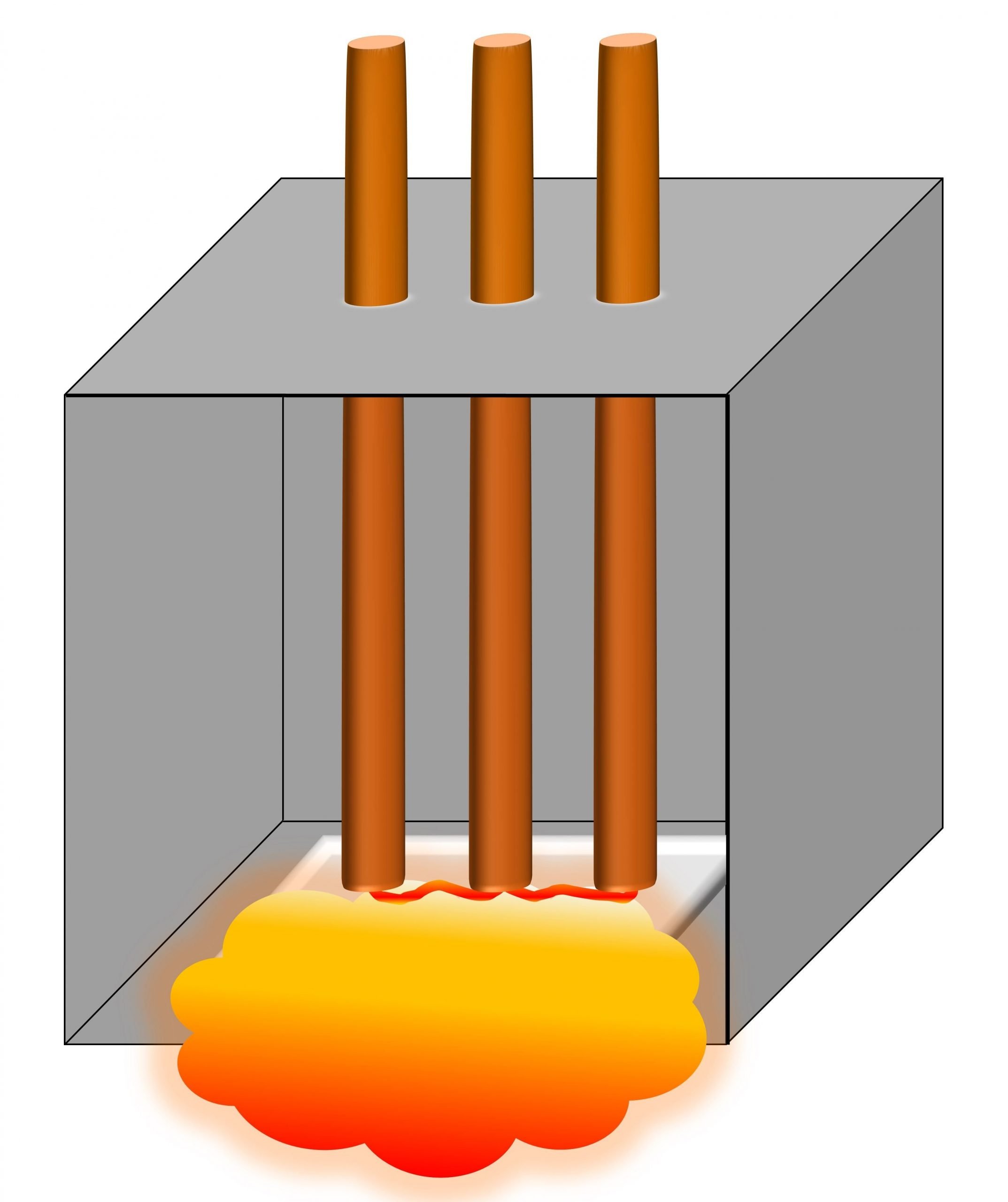

The 2002 edition was based on arc flash tests with electrodes in a vertical orientation as shown in Figure 1. When an arc flash occurs using the original model, the arc plasma is driven towards the bottom of the box and often spills out of the front.

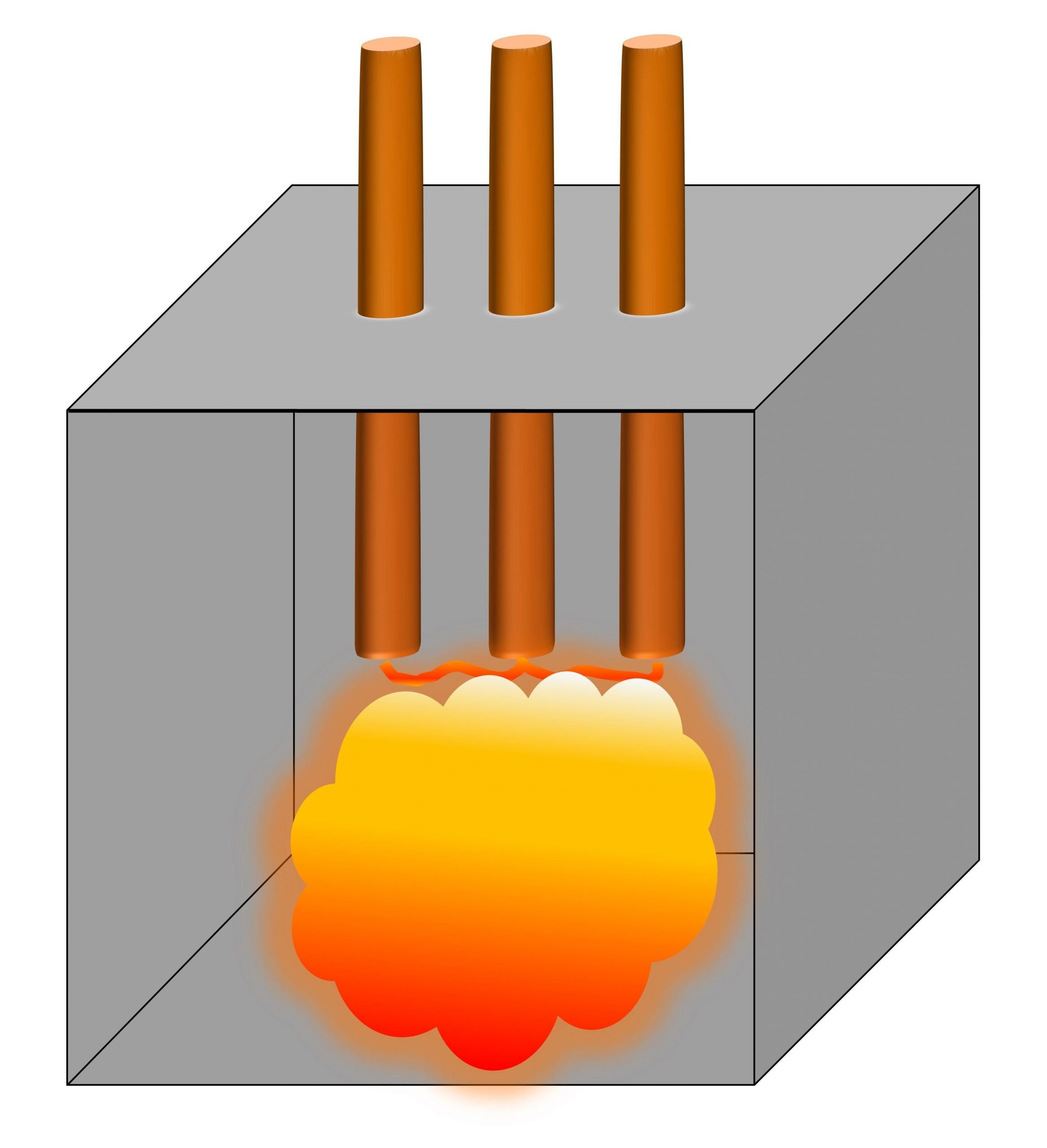

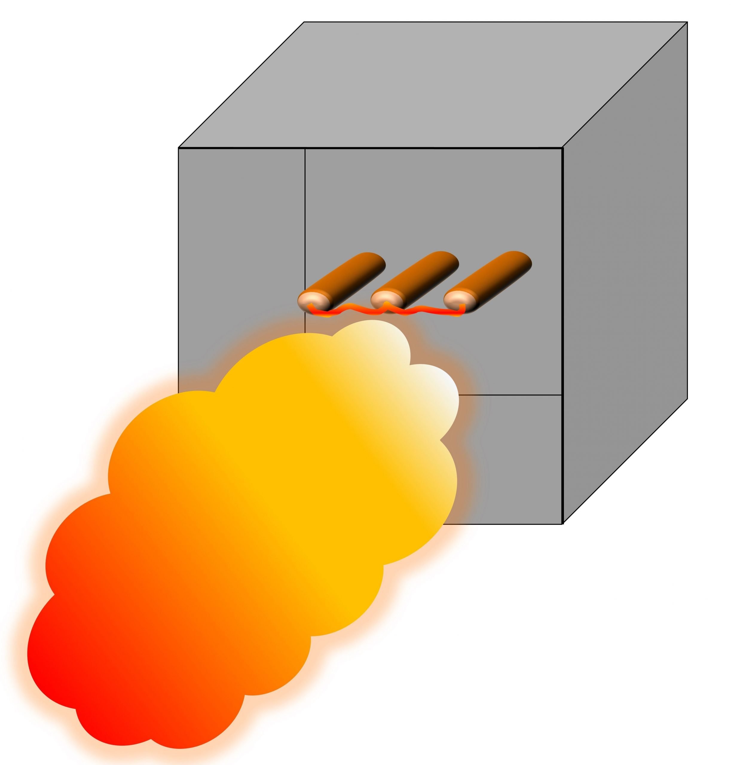

When the electrodes are placed horizontally, the arc plasma is directed from the ends of the electrodes outward.  Research has also indicated that if vertical electrodes are terminated into an insulating the arc hits the barrier and the plasma cloud is directed more towards the enclosure opening.

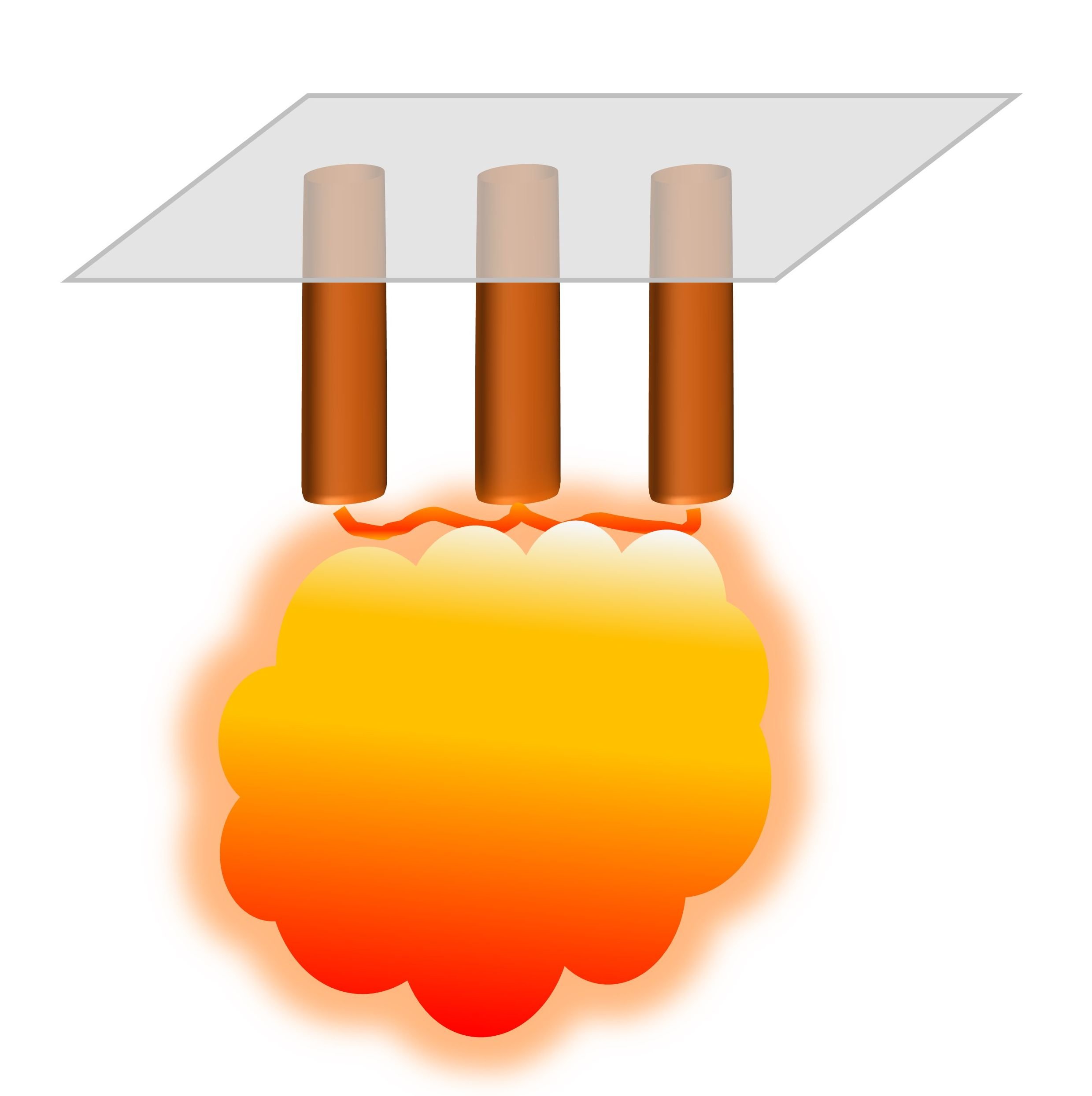

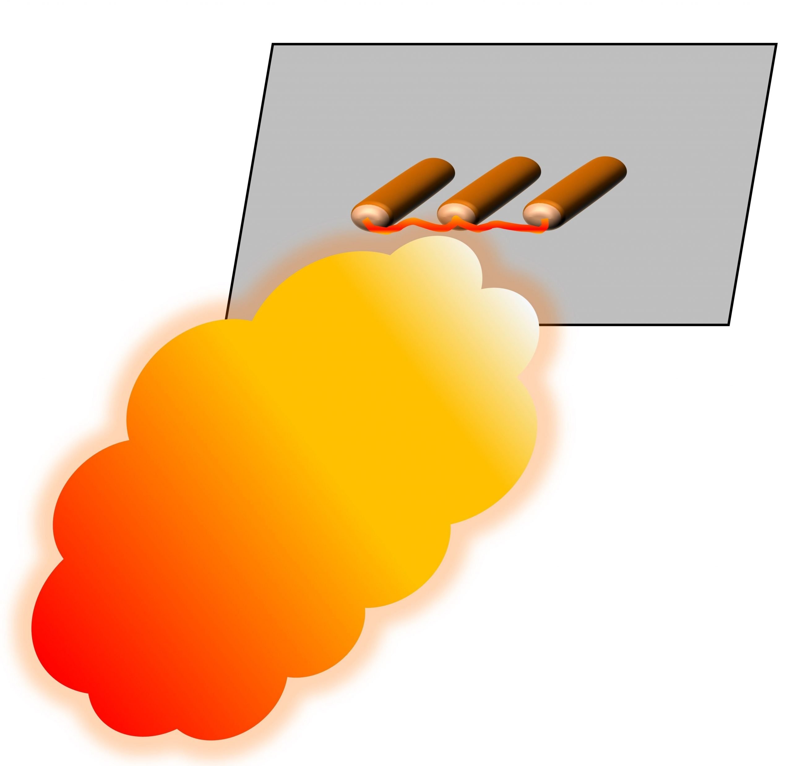

In addition, tests were conducted in open air and included the original vertical configuration in open air and a new configuration with the electrodes oriented horizontally.

  • Figure 1: VCB – Vertical electrodes in a metal box/enclosure (also in 2002 Edition)
  • Figure 2: VCCB – Vertical electrodes terminated in an insulating barrier in a metal box
  • Figure 3: HCB – Horizontal electrodes in a metal box
  • Figure 4: VOA – Vertical electrodes in open air (also in 2002 Edition)
  • Figure 5: HOA – Horizontal electrodes in open air
Figure 1. VCB
Figure 2. VCBB
Figure 3. HCB
Figure 4. VOA
Figure 5. HOA
