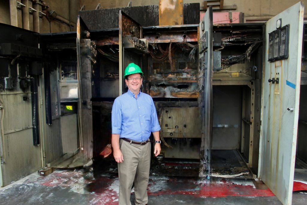

Jim Phillips, P.E. standing in front of electrical equipment damaged by an arc flash
Success! The damage looked similar to the Onagawa switchgear

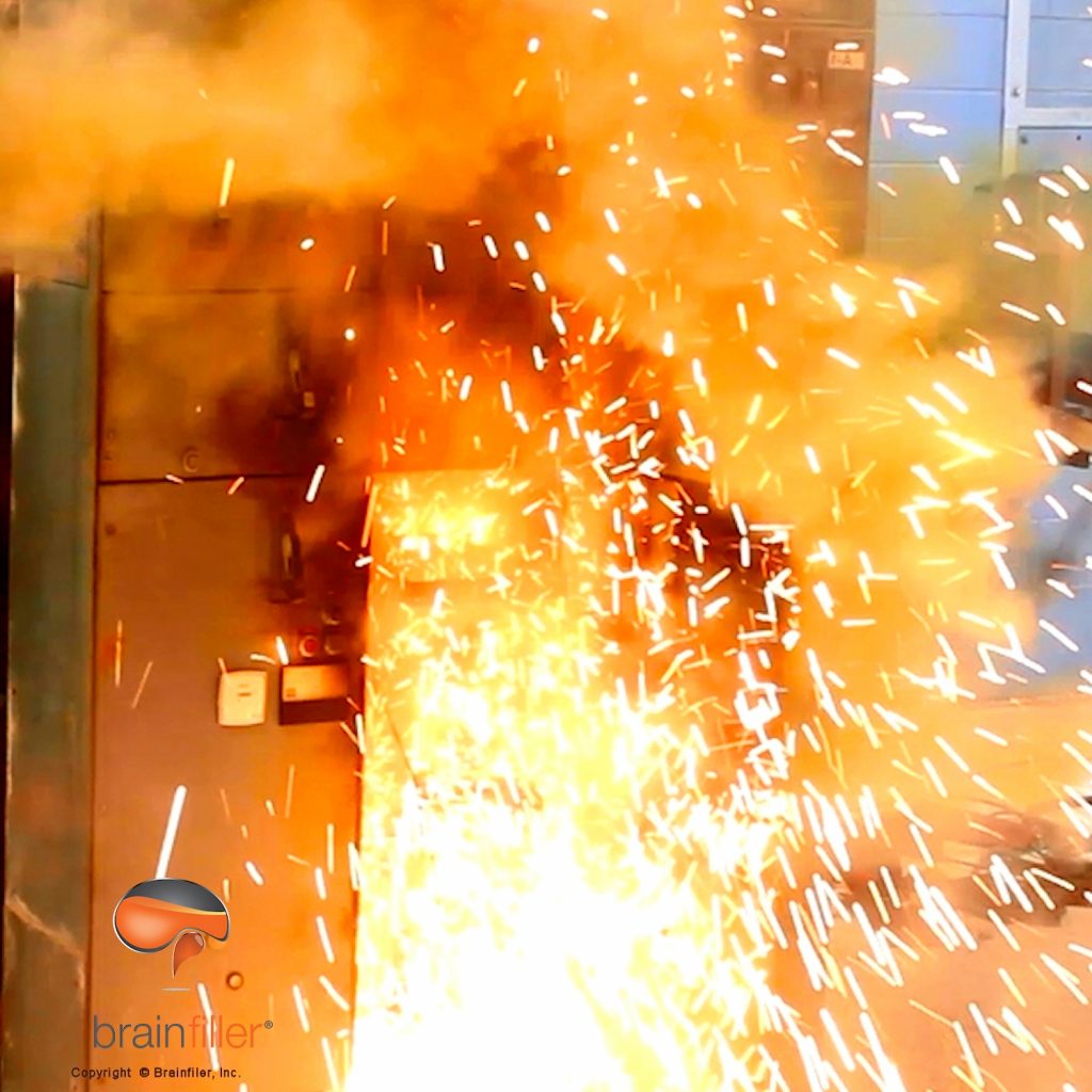

One of the early meetings was held just outside Philadelphia. The Japanese delegation walked us through the sequence of events at Onagawa. They had photos, timelines, equipment damage reports.  People began floating all kinds of theories about how the fire started but honestly, none of the explanations I was hearing made much sense from an electrical standpoint.

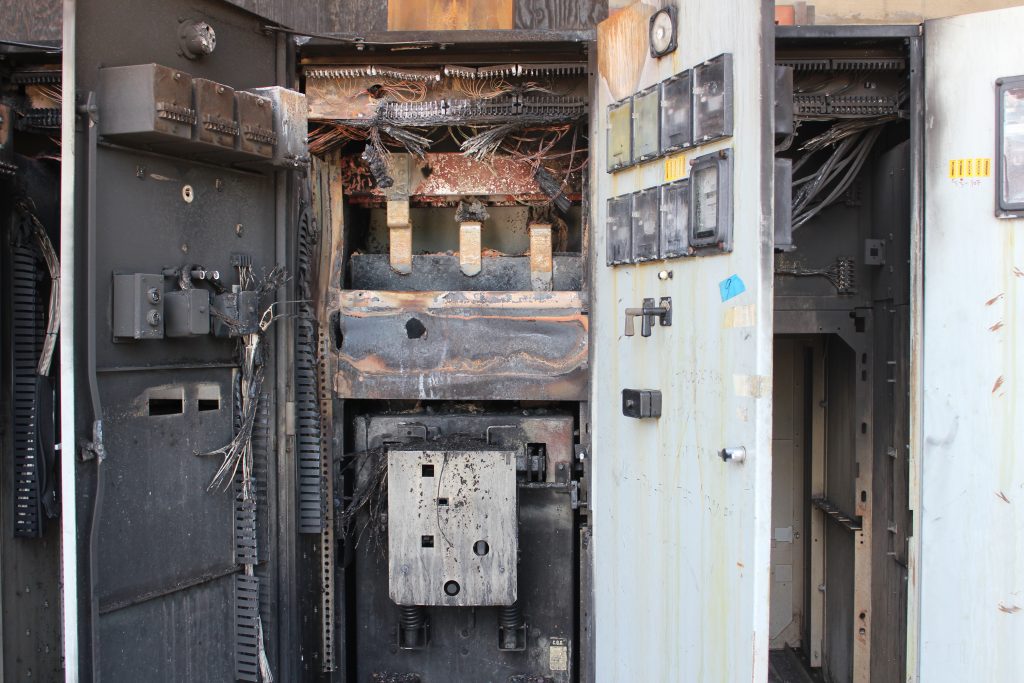

Then one slide popped up during the presentation. It was a photo of the damaged switchgear bus bars. They were seriously distorted.
And at that moment… Ding ding ding. I think I just figured it out from only one photo.
I asked a simple question: “How did the bus bars become deformed?” The assumption in the room was that the intense heat from the fire warped them. OK, here comes my follow-up question: “If heat caused the deformation… how did the top bus bar bend upward?”
Silence – No one knew.
So I opened my laptop and pulled up a high-speed arc flash video showing bus bars during a high-current fault. When massive short-circuit current flows through parallel conductors, the magnetic forces can be enormous. The Lorentz forces between conductors can cause bus bars to bend, distort, and repel each other.
So I now floated my theory.
9.0 Earthquake and Arc Flash
A magnitude 9.0 earthquake is hard to comprehend – I can not even imagine. The ground doesn’t just shake—it violently accelerates structures in multiple directions.
So what if the seismic motion caused something inside the switchgear to shift and bus bars to flex?
What if:
  1. The earthquake shook the metal-clad switchgear.
  2. Bus bars momentarily contacted each other.
  3. That created a short circuit.
  4. As the bus bars separated, the fault escalated into an arc flash.
  5. The arc flash energy ignited cable insulation or other combustible materials inside the gear.
That arc flash could release enormous energy—heat, vaporized metal, pressure waves, and molten particles. In nuclear safety terminology, this type of event is called a High Energy Arcing Fault (HEAF).

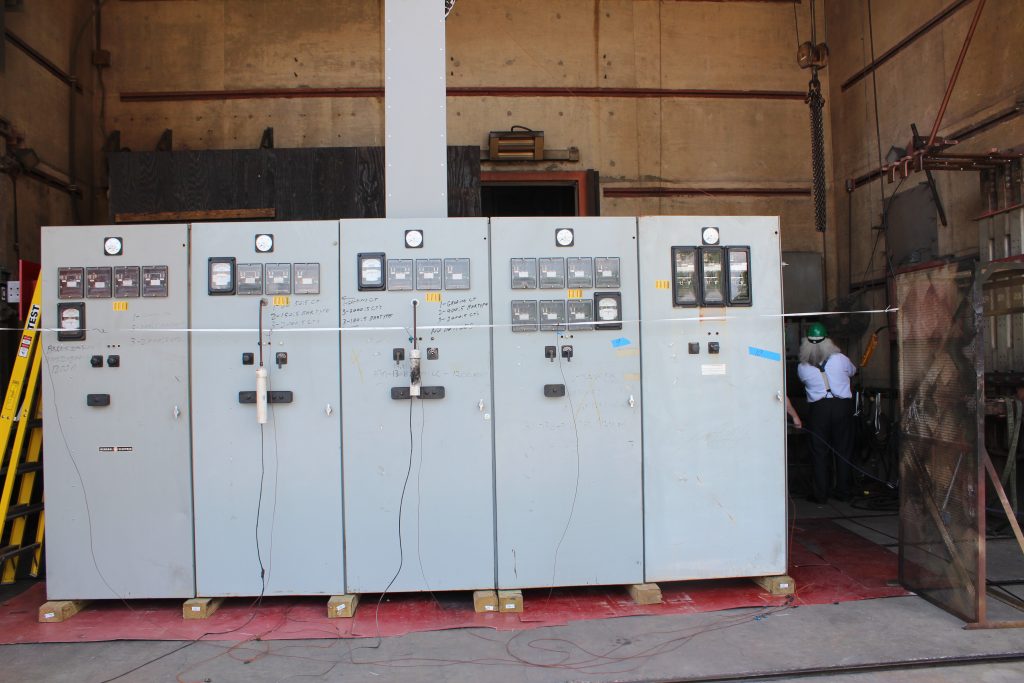

I’ve been involved in a lot of arc flash tests over the years. Some were very impressive, but not as impressive as what was about to unfold with these tests. The most dramatic one I was ever responsible for was about to occur and involved 15 kV switchgear operating around 7 kV – very similar to what existed at the Onagawa plant.
The objective was simple: Can an arc flash ignite insulation and create a sustained fire?
We had three days. Each day followed the same routine:
  1. Install new switchgear
  2. Add instrumentation and calibrate the test circuit
  3. Set up high-speed cameras
  4. Configure the fault
Then during the last hour…
Three – Two – One – KA-BOOM!
Day 1 On the first day, we got a spectacular arc flash complete with a huge plasma, molten metal, blast pressure, a fire and major damage. But the fire didn’t sustain. Exciting and disappointing all rolled into one.
That night I went back and studied the video footage as a postmortem. Why no sustaining fire? We decided to tweak the trigger wire configuration and arc duration to increase the energy release.

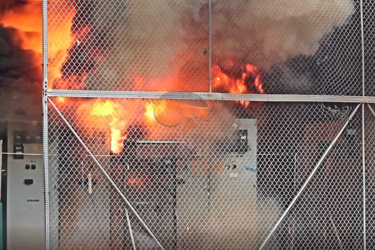

Day 2 The next test was even more spectacular. The arc ignited, the plasma and thermal energy blasted out of the gear, and for a moment everything went quiet.
Then I noticed a little flicker behind a hole where there used to be a pistol grip:
“Wait… is that a fire?” I exclaimed?
Yes, A small flame appeared. Then it grew. And grew. AND GREW! It became quite an inferno.  The switchgear was sitting a few inches off of the ground and the wire way shown in the photo, was packed with cables that caught fire.  We had the perfect chimney effect. Air entering from the bottom and the wireway acting as a flame thrower towards the ceiling!
Then someone from the delegation turned to me and asked: “Mr. Phillips… how do we extinguish this fire?”
For a split second I panicked. Then I realized something. I had been brought in to create the arc flash and sustained fire, not to figure out how to put it out. So my response: I have no idea!
Be careful what you ask for.
Fire visible behind a mesh enclosure during an electrical test

Damaged industrial electrical switchgear cabinet
Amazing damage!
The Ultimate Fire Drill
I was concerned we were going to burn the lab down. The lab was not prepared for such a fire.  However after about 15 minutes of controlled chaos, the fire was finally extinguished. How? The old-fashioned way. A garden hose. Fortunately, the equipment had already tripped offline and been electrically isolated, so there was no electrical hazard during the firefighting.
A side story: I was discussing this event recently with a person at a conference. When I got to the description of the fire and fear of burning down the lab,  his face lit up and exclaimed; “So you’re the one!!”   What?  He said he was just at this lab and someone there was telling the story of a person that came close to burning the lab down.  OK, I guess that is my claim to fame.
But the test DID prove something important. HEAF events can release enormous energy in milliseconds and may eject hot gases, molten metal, and debris that ignite nearby combustible materials.
The Onagawa switchgear fire became a major case study for the nuclear industry. It demonstrated that arc-flash-driven HEAF events can cause fires and mechanical damage extending well beyond the equipment enclosure, which led to new international research programs and regulatory attention focused on understanding and mitigating these hazards.
