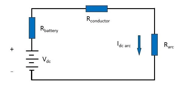

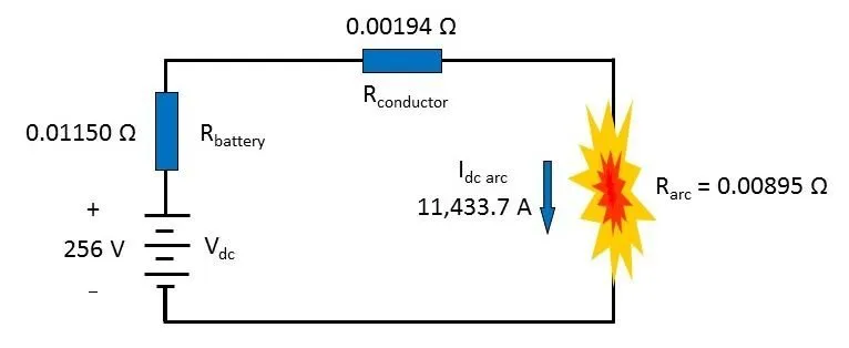

By including the dc arc resistance as part of the dc circuit model illustrated in Figure 1, the arcing current can easily be determined. This circuit diagram is of a battery string and includes the dc voltage, dc battery resistance, conductor resistance and dc arc resistance. As part of the overall process, the dc arc resistance must also be calculated since it is usually not known. Once all of the resistance values have been determined, the dc arcing current, Idc arc can be calculated by:
Idc arc = Vdc / (Rbattery + Rconductor + Rarc)
The DC Arc Models paper also refers to another important document titled “Electric Arcs in Open Air” published in the Journal of Physics D: Applied Physics in 1991 by A. D. Stokes and W. T. Oppenlander. The research included in this document led to the development of the following equation for arc resistance:
Rarc = [20+ (0.534 x G)] / (Idc arc ^0.88)
Where:
Rarc = resistance of the arc in ohms
G = conductor gap distance in millimeters
Idc arc = dc arcing current
Calculating the arc resistance requires the conductor gap distance G and the dc arcing current must be known. However, to determine the dc arcing current, the arc resistance must already be known. This creates an interesting dilemma since the arcing current is needed to calculate the arc resistance and the arc resistance is needed to calculate the arcing current.
An iterative solution can be used to solve this problem. To begin, an initial assumption of the dc arcing current must be made. A reasonable assumption is that the dc arcing short circuit current is 50% of the dc bolted short circuit current. Once this initial assumption is made, the dc arc resistance can be calculated which is then used to re-calculate the dc arcing current. The “new” dc arcing current can then be used to re-calculate the dc arc resistance. This process continues until the dc resistance and dc arcing current values no longer change significantly and converge to a final answer.
DC Arc Resistance and DC Arcing Current Calculations – Iterative Solution

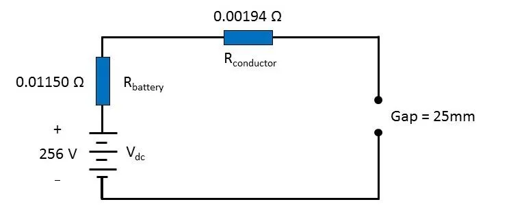

Figure 2 illustrates the circuit that is used as an example for calculating the dc arc resistance and the dc arcing current. The calculation process begins by determining the dc bolted short circuit current first. This requires taking the dc voltage (Vdc) and dividing by the known impedances of the conductor and battery string.
Begin by solving for the bolted dc short circuit current using the values Figure 2. For the bolted case, Rarc and the conductor gap distance are ignored and only the resistance of the battery string and conductor are used.
Idc bolted = Vdc / (Rbattery + Rconductor)
Idc bolted = 256V / (0.01150Ω + 0.00194Ω) = 19,048 Amps
As a first approximation of the dc arcing current, Idc arc:
Idc arc = 0.5 x Idc bolted
Therefore:
Idc arc = 0.5 x 19,048 Amps
Idc arc = 9524 Amps

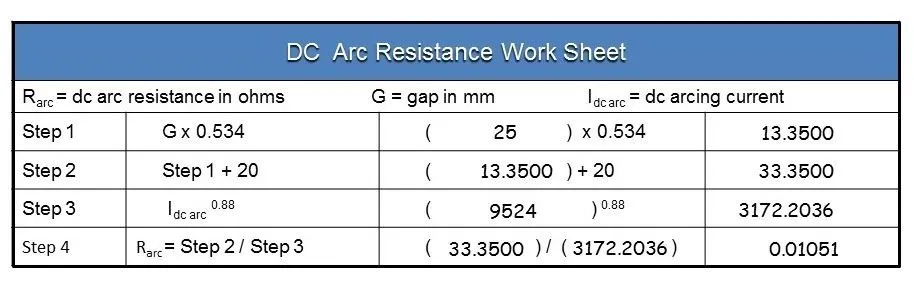

The dc arc resistance worksheet shown as Figure 3, is used for calculating the dc arc resistance of this example. It provides a step by step method for calculating the dc arc resistance based on the Stokes/Oppenlander equation. To use the worksheet, the following data is required:
Conductor gap distance in millimeters (mm)
DC arcing current
Step One: Enter the conductor gap distance G in millimeters (mm) and multiply by 0.534. The gap distance must be defined by the user. IEEE 1584 provides a table of “typical” gap distances.
Step Two: Add the constant 20 to the result found in Step One
Step Three: Enter the arcing short circuit current, Idc arc and raise it to the power of 0.88. Since the arcing short circuit current is not usually known, a typical first approximation is to assume that Idc arc = 50% of Idc bolted.
Step Four: To obtain the dc arc resistance in ohms, divide Step Two by Step Three. The following example illustrates how to calculate the value of the dc arc resistance based on the initial assumption of the dc arcing short circuit current. After the dc arc resistance has been calculated, iterative solutions can be used.
For this example, an arc gap of 25 mm was used which is one of the “typical” values given in IEEE 1584. Using the first approximation of 9524 A which was calculated previously for the arcing short circuit current, the arc resistance Rarc is calculated as 0.01051 Ω as shown in Figure 3.

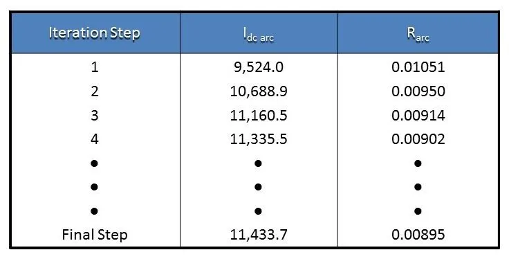

The next step in this process requires a series of iterations. The calculated value of Rarc can now be added to the original circuit and the dc short circuit current can be re-calculated as follows:
Idc arc = 256 V / (0.01150 Ω + 0.00194 Ω + Rarc)
Idc arc = 256 V / (0.01150 Ω + 0.00194 Ω + 0.01051 Ω)
Idc arc = 10,688.9 Amps
Once the new value of Idc arc has been calculated, it can be substituted back into the dc arc resistance worksheet and a new value of Rarc can be calculated. The iteration process continues until the values of Idc arc and Rarc do not change significantly from the previous values and converge to the final answers of 11,433.7 A for Idc arc and 0.00895 for Rarc as illustrated in Table 1 and Figure 4.

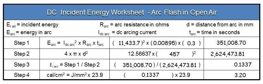

A worksheet that is based on this equation and used to solve the arc flash in open air example problem is shown as Figure 5. It breaks the calculation process down into individual steps. A final step is added which converts the units from J/mm2 to the more commonly used units of calories/centimeter2 (cal/cm2).
The worksheet requires the following data:
DC arcing current in amperes, Idc arc
Arc resistance in ohms, Rarc
Arc duration in seconds, tarc
Distance from the arc in mm, d
Step One: Enter Idc arc, Rarc and tarc obtained from the previous iterative calculations. Square the Idc arc value and multiply by Rarc and tarc to determine the energy in the arc, Earc in terms of watts-seconds or Joules.
Step Two: Enter the distance from the arc (working distance) in mm. Multiply d by 4 x π or 12.56637
Step Three: Calculate Ei air by dividing Step 1 by Step 2. The result will be in J/mm2
Step Four: Convert the answer obtained in Step 3 from J/mm2 to cal/cm2 by multiplying by 23.9
Using the dc arcing short circuit current and arc resistance that was previously calculated, the incident energy can be calculated. This requires knowing the working distance from the prospective arcing location to the worker as well as knowing the duration of the arc flash. For this calculation, a maximum arc duration of 0.3 seconds was used. This value would normally be defined by the characteristic of an upstream protective device.
A working distance of 18 inches (457 mm) was used which is a “typical” value obtained from IEEE 1584.

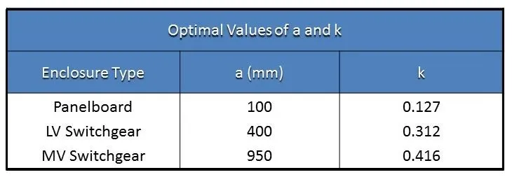

If the dc arc flash occurs in an equipment enclosure, the energy will be directed out of the open end of the box. For this calculation, the DC Arc Models paper refers to another technical paper titled “Simple Improved Equations for Arc Flash Hazard Analysis,” IEEE Electrical Safety Forum, August 30, 2004 by R. Wilkins.
According to this paper, the equation for determining the incident energy from a dc arc flash being focused out of an enclosure is:
Ei box = k x Earc/(a2 + d2)
Where:
Ei box = incident energy from an arc flash in a box at distance d in J/mm2
Earc = arc energy in watt·seconds or Joules
d = distance from the arc source in mm
a and k are obtained from optimal values defined in the Wilkins paper and listed in Table 2.

Using values that were previously calculated for Idc arc and Rarc, the incident energy will now be calculated based on the arc flash occurring in a box/enclosure. The enclosure is assumed to be a panelboard and the same working distance and arc duration from the earlier example are used.
To begin this problem, the values of a and k must be determined. Obtaining these values from Table 2 for a panelboard indicates the value of a is 100 and k is 0.127. The previous calculations indicate that Idc arc = 11,433 Amps and Rarc = 0.00895Ω. The working distance, d is 457 mm and the duration, tarc is 0.3 seconds.
These values can be used with the dc arc flash worksheet for calculating the incident energy in an enclosure as illustrated in Figure 6. The result for this calculation is 4.9 cal/cm2.
