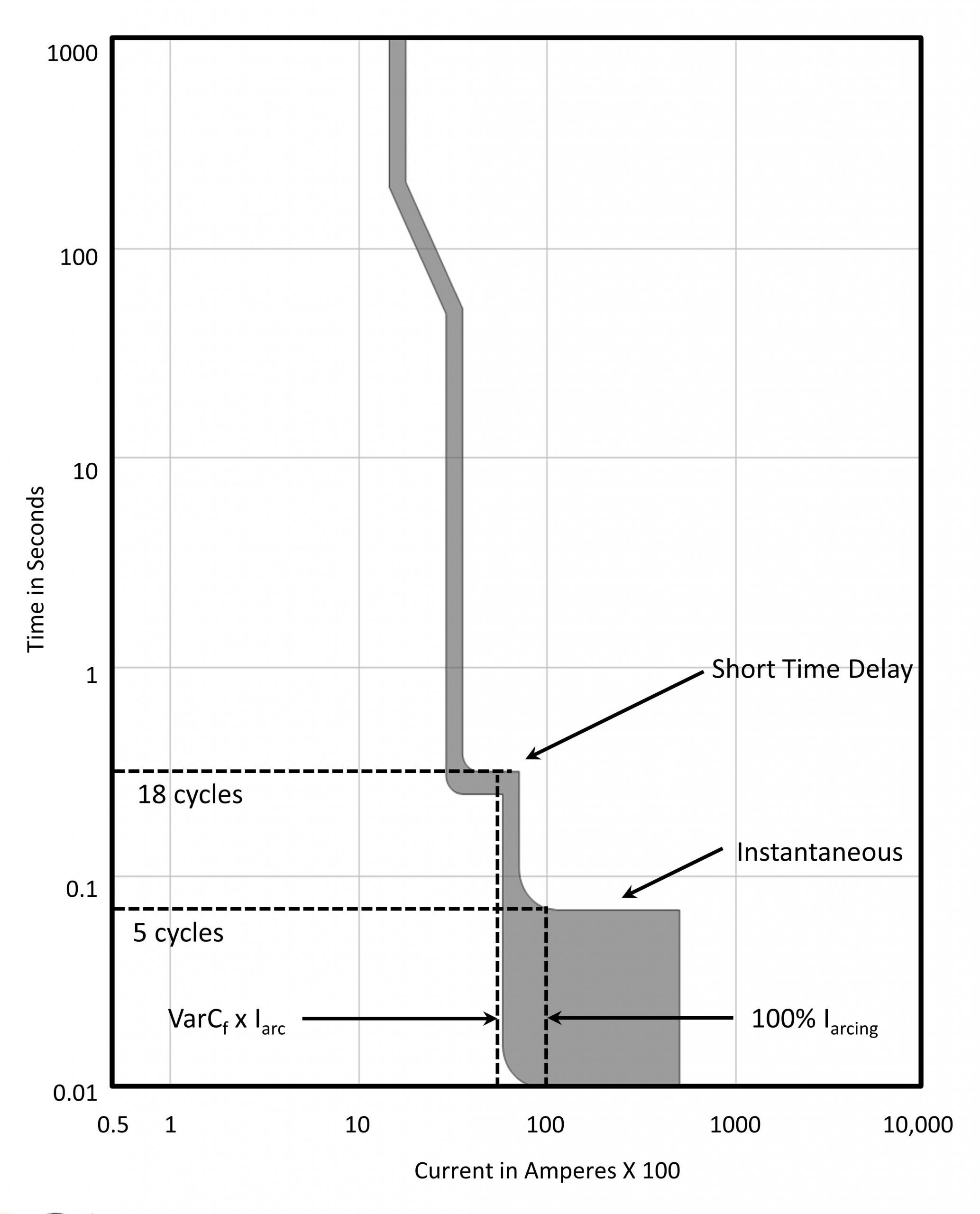

Figure 1. Time Current Characteristic and VarCf

The time-current curve in Figure 1 illustrates how a slightly lower arcing current causes the protective device to go from a 5 cycle clearing time to 18 cycles – Over three times as long!
