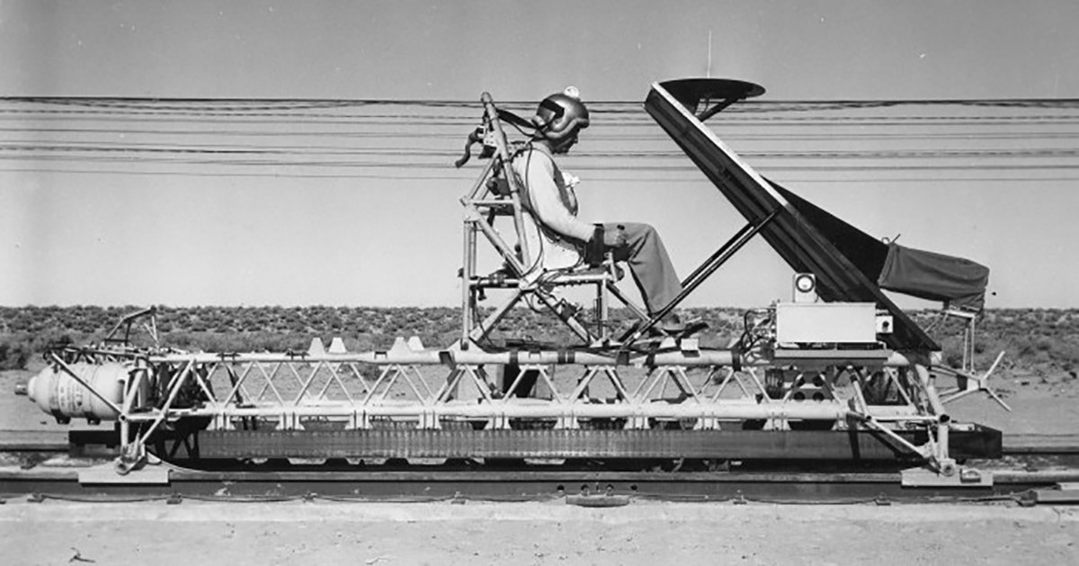

Around seventy years ago, Captain Murphy was an aerospace engineer who worked on safety-critical systems. He became involved with high-speed rocket sled experiments used to determine what G-forces a human could experience while being hurled down the rails at an alarming speed – 632 miles per hour back then. Note: speeds today can exceed well over 6000 miles per hour!
The “passenger” would be restrained by a harness that contained a series of measurement sensors – however, during the sled’s run, the sensors were not functioning! A subsequent investigation found
the sensors had been wired backwards. Openly upset, Captain Murphy made his thoughts known to the technician that allegedly was responsible for the problem. Although there are varying accounts of what exactly was said, it was something along the lines of:If there are two ways to do something, and one of those ways will result in disaster, he’ll do it that way.
