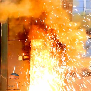

Minor sparks?  Deadly explosion?  An arc flash calculation study, typically based on equations from IEEE 1584, can be used to predict how much incident energy (IE) in calories/centimeter2 (cal/cm2) can reach a worker.  This assumes the person is standing at a specific distance from the source of the arc known as the “working distance”.  Depending on the type of equipment, this “working distance” as it is called, is typically defined as either 18 or 36 inches however other distances may be used.
Once the incident energy (IE) has been calculated, it can be used to select the appropriate personal protective equipment (PPE).  This seems simple enough, but caution must be used because the calculated IE is based on the “working distance” between the potential arc source and the worker’s torso, face and head.  Move closer and the incident energy can go up dramatically.
