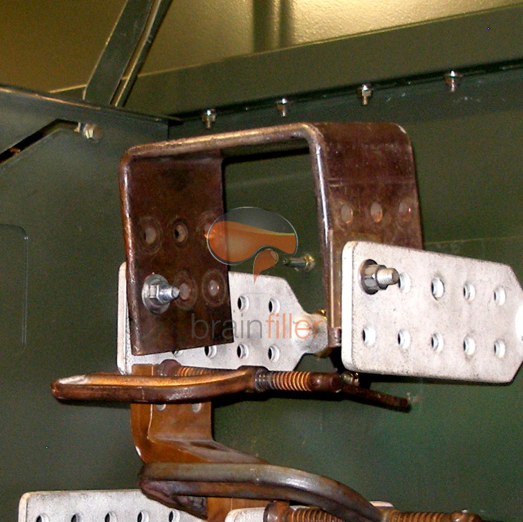

Bolted Fault Current
A bolted fault represents a theoretical condition with zero impedance between conductors, resulting in the maximum available fault current. The term reflects laboratory conditions during a short circuit test. When calibrating the circuit, the test circuit is shorted by “bolting” the phases together with large bus bars as I have done in the laboratory and illustrated in the photo.  Hence the term “bolted fault current”
Jim uses a busbar to "bolt" the phases together in the lab
Arcing Fault Current
An arcing fault, however, includes the impedance of the electrical arc itself, which limits current flow. For this reason, arcing fault current is always lower than bolted fault current.
