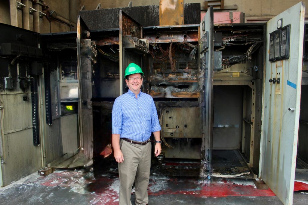

Arc Flash investigation
Fukushima after Arc Flash
