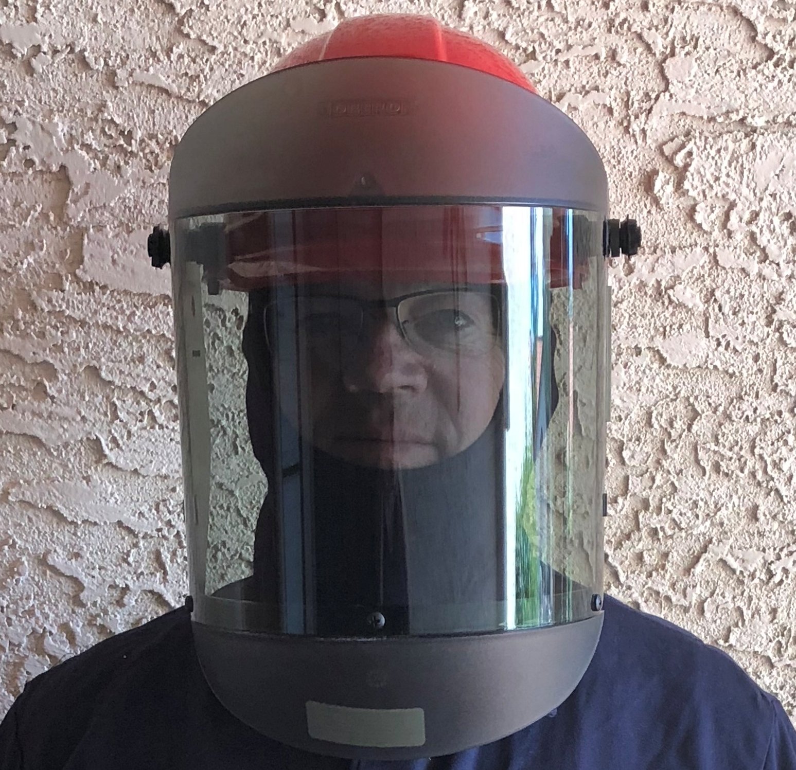

Balaclava. The word “hood” and “sock” were deleted and the definition was changed to: “An arc-rated head-protective fabric that protects the neck and head except for a small portion of the facial area.”

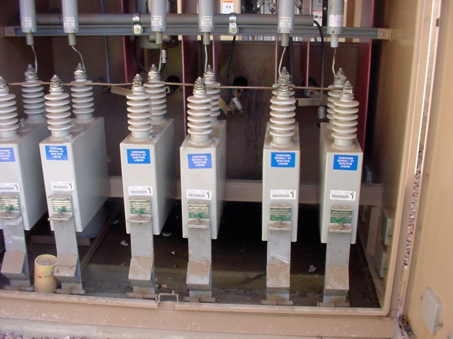

Article 360 Safety-Related Requirements for Capacitors. This new article has been added regarding safety and capacitors. In the past, capacitors have had only a brief mention including the statement introduced in the 2018 edition “Release stored electrical energy” as one of the steps in the process of establishing an electrically safe work condition. This new Article contains six sections:
360.1 Scope.
360.2 Definitions.
360.3 Stored Energy Hazard Thresholds
360.4 Specific Measures for Personnel Safety
360.5 Establishing an Electrically Safe Work Condition for a Capacitor(s)
360.6 Grounding Sticks

Informative Annex R Working with Capacitors
This new annex was added as additional information regarding capacitors.
