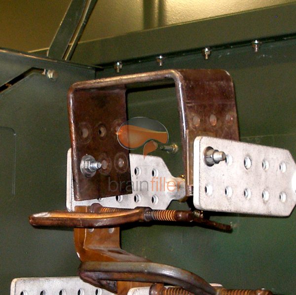

Arcing Fault Current, NFPA 70E and IEEE 1584
Question: Why isn’t there a fixed percentage difference between the bolted and arcing fault current? IEEE 1584, Guide for Performing Arc-Flash Hazard Calculations, provides the technical foundation used to calculate incident energy and arc-flash boundaries in electrical power systems. A key element in this standard is the calculation of the arcing fault current, which differs from the bolted fault current typically obtained from short-circuit studies. While IEEE 1584 defines the calculation methodology, NFPA 70E relies on these results as part

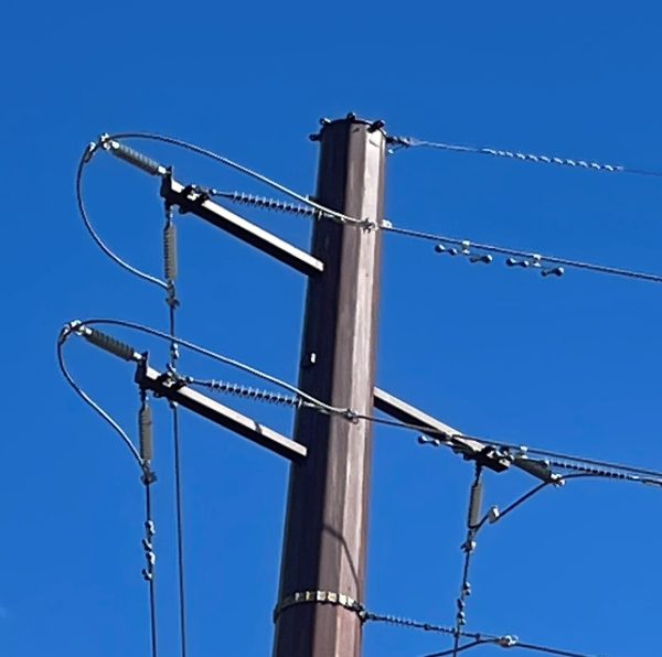

Arc Flash Calculations above 15 kV
NFPA 70E and Arc-Flash Calculations Above 15 kV
NFPA 70E and Arc-Flash Calculations Above 15 kV Question: Can IEEE 1584 be used for higher voltages, such as 23 kV or 34.5 kV systems? Short answer: No. This is a very common questions I receive during my training about NFPA 70E Article 130.5 (Arc-Flash Risk Assessment) and IEEE 1584. The IEEE 1584-2018 equations for incident energy, arc-flash boundary, and arcing current are only validated for systems from 208 V through 15 kV. Once you go above 15 kV, IEEE
